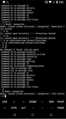

Ok on typing in:
$ mkdir .mosquitto replies - cannot create directory .mosquitto: read only file system
I tried:
$ ls replies - cannot open directory : permission denied
It doesn't seem to like any Linux style commands
Are you doing this on the phone? Looking back at my notes I use ssh to connect to it and was able to do everything from my laptop.
Try
cd /data/data/com.termux/files/home
to see if that gets you do the right place.
Seems like a strange editor when used on the phone! Edit: hold on just noticed the file already exists sorry. Can I create a folder and create a file using this editor? I'm not sure
What is in the folder?
ls .mosquitto/
If the conf file is already there then you should just be able to add the new bit on the end. I installed the editor nano.
pkg install nano
but again I did everything through ssh rather than on the phone.
ls .mosquitto doesn't return with anything, no list just a $ prompt.
Will try to ssh to the phone as working on a small touch screen is a real pain.
So the folder exists but is empty, so you should just be able to create the conf file.
