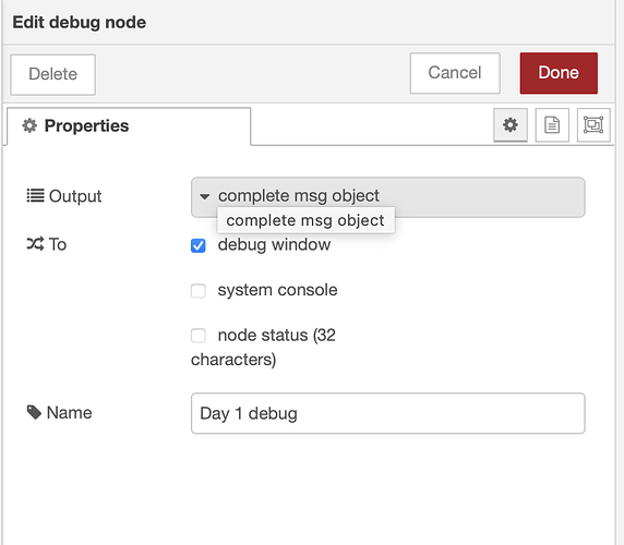

msg.payload is undefined but there are other items that are defined and used in the flow. If you change the output of your debug to “complete msg object” you will see the other data.
You can send the data as msg.payload (or any other name) and make the appropriate changes in this section of the function node where the incoming data is used.

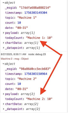

See if this works for you. I added in a new property (msg.todayCount) that is the output of the function node. However, it assumes that there is only one machine (could probably be enhanced to do multiple machines)

The first function you gave for a new property (msg.todayCount) appears to be working great so far.
Fab!
Try this flow - I tested this with a test of 5 bars. On the 6th, it drops the first one and add the last one. You can change it to 30 to keep a running set of 30 days data.

I also added in the Machine name to the today’s count so it should take into account different machines.
UPDATE: This does not work for multiple machines on the same chart (it will work for a single machine).

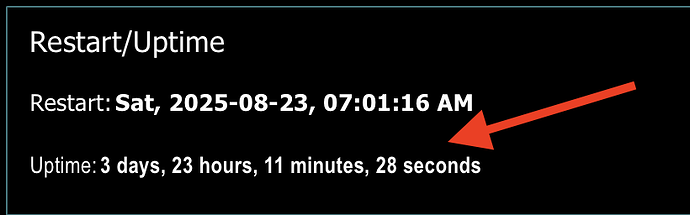

  4. I am working on another copy of this function that basically does the same thing but with counting operating time for the machine. It works. I am now using a node that gives me the milliseconds for each run, which I can convert to minutes or seconds and this works as-is with your function, but can we change the function to give us mins, secs In the bar charts? If possible that would be nice.

Above is a function I use to calculate uptime. Maybe it can be adapted for your requirements?
Hope this helps.

I did look for multiple todayCount and as far as I can tell there is just the one.
Edit: Apologies, it is there if I switch on the different names, I got confused.

Yes - the output is just one since it is triggered by a single “start”. However, the output contains the name of the machine and the count.
You can modify the output (eg. turn it in todayCount.machne, todayCount.count) etc. and then use it the way you want to.
