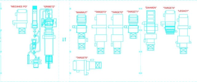

Hello,
I'm having problems in displaying pictures on node-red dashboard.
I'm using template node to display an image from hosting service. Image is an PNG converted from PDF, resolution is full HD (in width) without background.
However, when loaded with template it looks like its a lot smaller resolution:
 ![image](https://us1.discourse-cdn.com/flex026/uploads/nodered/original/3X/3/8/382019a6611104114e6390620e831899af75806b.png)
Here is the original from hosting service:
 ![image](https://us1.discourse-cdn.com/flex026/uploads/nodered/original/3X/a/4/a4ce92c34fabfce4094b7a64ca55543b5a389d05.png)
The code I'm using is here:
`<img src="https://i.ibb.co/PgpCYVt/nazivi-stepeksa2.png">`
Why does it get so bad?
Also, when trying to use a 4k resolution picture I have no control over the "container" where the picture is located. E.g. when I try to reduce its dimmensions then I get cropped picture.
