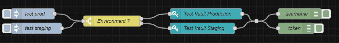

I just played with creating 2 dummy vaults: Production and Staging
In each, 2 groups: Service1 and Service2
Each group have: 1 "username" a-z field and 1 "token" password-field
I ended up with something like that:
I believe it's up to everyone but I'm still wondering if for my use case I should use vaults/groups as environments/services, or the way round....
May be if vault/group could come from the message to avoid that switch node... :smiley:
