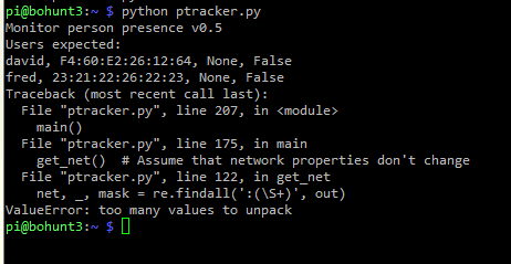

How do I kill 'ptracker.py' in the shell?
Here's screenshot of running ptracker.py manually in foreground.
Cheers from David.

David, you found my bug!
Thank you!
I fixed it in version 0.5.1 (Bugfix: network config parsing was not enough robust.) Published.
Please, give it another try manually.

After a bit of trail and error got the script running, but i'm getting a "Error: Network configuration is weird.". Any restrictions regarding network configuration?
The error means 'ifconfig' command returned nothing or gibberish.
The script is designed to run on Raspbian. It won't work on Windows and some Linux distribution which don't have ifconfig utility.
