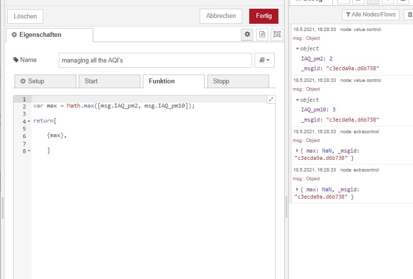

The problem seems to be in the function node "managing all the AQI'S".
I want to manage all the numbers i get from before ( 1 to 5) to output always the highest one.
I try'd it with the Math.max() function I found but I don't know if it just don't work or if i messed up entirely :smiley:
And i don't know why i get the var max outputed twice, but thats no problem I just wondered :smiley:
Edit: Or does it just don't work because i haven't connected the other parameters? I thought that they are just 0.
EDITEDIT: Nope, i just tried it without them :smiley:

ok I changed the car and the function, now i get NaN, what is that supposed to mean ? :smiley:
Where exactly do i have to put "node.warn()" in ? In the line with the var max or in the return part?

I just want one thing. as you can so i recieve in the debug "value control" to numbers. one is called "IAQ_pm2" and the other one is "IAQ_pm10". I just want that always the higher number gets returned. So in this case below, I want that the debug "extracontrol" shows the number "3", because its the higher one.
And I want this procedere with 5 parameters as you can see. But now I can only test it with these two because the other sensors are not connected right now.
So do you have an example how I should code the function node "managing all the AQI's" that I get always the highest number of all 5 inputs?
I already tried that, doens't work.
The function node is now like this.
Math.max takes a list of parameters, not an array.
Get rid of the square brackets.
var max = Math.max(var1, var2)
I tried this. What am I doing wrong?
You have removed the msg. as well as the square brackets.
When i try "msg.IAQ_pm10" i get "NaN".
I thought I should get rid of them ?
If you look at the debug node output you will see that each message only contains one of the values, the other one is not present so you can't take the maximum of the two of them, as only one is available at a time. If these values are coming in from different sources then you need to join the messages together to give you both in one message.
See this article in the cookbook for an example of how to join messages into one object.
Note that you will need the values in msg.payload and each source must have a unique topic. It is almost always more convenient to put values in msg.payload anyway, most nodes expect, by default, the data to be there. If you don't understand what I have just written then I recommend watching this playlist: Node-RED Essentials. The videos are done by the developers of node-red. They're nice & short and to the point. You will understand a whole lot more in about 1 hour. A small investment for a lot of gain.
Also read the node red docs page Working with Messages. Unless you understand what is on that page you will find things very difficult.
As with many things in life there are so many alternatives. One is to use context to capture the values from the incoming messages. An example like this I think will work (you have to extend it to cover all your values). Try the code in your function node
if(msg.IAQ_pm2){
    context.set("IAQ_pm2", msg.IAQ_pm2);
if(msg.IAQ_pm10){
    context.set("IAQ_pm10", msg.IAQ_pm10);
if(context.get("IAQ_pm2") && context.get("IAQ_pm10")){
    let max = Math.max(context.get("IAQ_pm2"), context.get("IAQ_pm10"));
    msg.payload = max;
You are the greatest man :smiley: It works perfect.

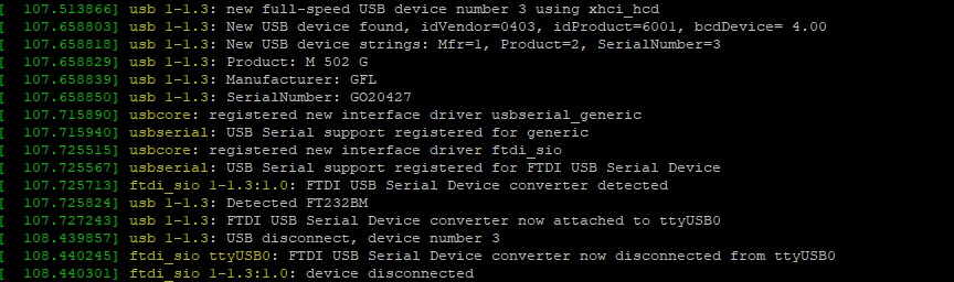

I think I changed all the lines you mentioned in the script. When I start it I get the following.
Screenshot 2021-06-30 124551
Has this something to do with that I don't know which bit contains the right information or is there another problem I didn't see? :confused:
lux.py.txt (3.1 KB)
EDIT: I found out that the device disconnects really fast, maybe this is the problem that the script doesn't detect anything because it's already disconnect?
