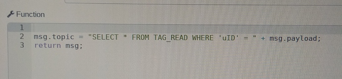

Thanks Colin for your suggestion. Now the scenario looks like as below, after implementing the procedure you advised me.
  1. Before that, I would like to mention that now my msg.payload is just a 'uID' as I have removed the string "RFID detected is:". So that I can just get my uID for context.data.uID from altairsmartcore via MQTT.
  2. Below shows the function node syntax that I used and the 2 outputs that I got before and after the function node, but the debug node after my SQL node is not giving any output.
  3. Is it necessary for the column in my Database to be a "Primary Key" to be able to extract data when equated with msg.payload?
Thanks a lot for having patience and answering my not so wise questions. Please find the images attached.
Best Regards
@ukmoose I have shared the screenshot of my INPUT to Database node below
In your function node I would rather use something like this.
let data = msg.payload;
msg.topic = 'SELECT * from TAG_READ WHERE uID = ?';
msg.payload = [data];
The query is passed in the msg.topic as usual, but having the ? placed for each parameter. The values are passed in the same order in your msg.payload as an array.
Otherwise you can end up with some nasty SQL injections.
One other thing I saw. Don't use 'uID', just uID in your query. You are literally comparing two strings, and not evaluating against your uID column.
Say your payload is the string '12345678', then your WHERE clause would look like 'uID' = '12345678'. This condition will never be true, thus the empty result.
(Unless your uID is literally 'uID' of course, then you would receive the content of the whole table :boom::grinning:)
