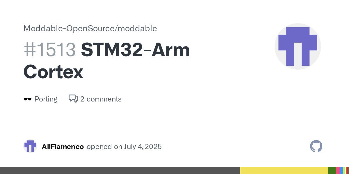

I want to add nodes to node-red-mcu. I am a senior embedded developer and lately I knew node-red. I like to help and develope nodes to node-red-mcu and make it better to use for other people.
As I understood, If I want to add MCU like LPC1768, I should add hardware platform to Moddable firstly.
That's a pretty long way to go - as you would have to integrate this into the SDK in all its depth.
yes that is not simple, but useful. It can be done for arm cortex-m3 generally.
This link is for discussion about it.
