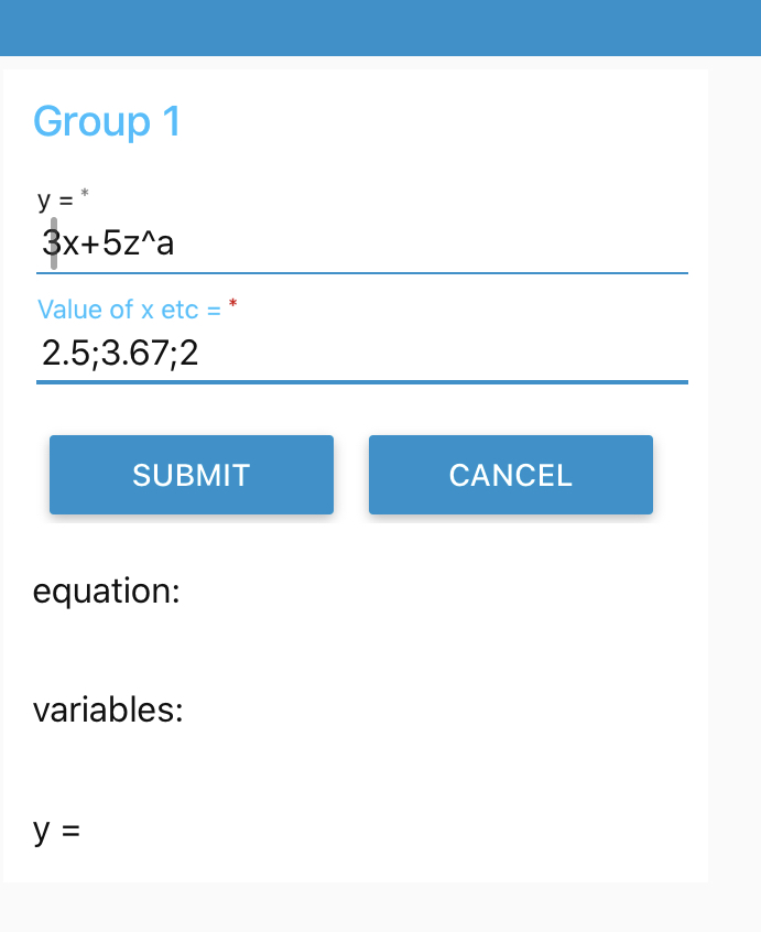

I have something to play for you;
[{"id":"4a79662.d4d4498","type":"function","z":"f954564f.03e718","name":"solve input","func":"const nerdamer = global.get(\"nerdamer\");\nconst solvethis = msg.payload.equation;\nconst variables = msg.payload.variables;\nconst test = nerdamer(solvethis,variables);\nmsg.payload = test.text();\nreturn msg;","outputs":1,"noerr":0,"x":1130,"y":1220,"wires":[["a93b1f86.c23498"]]},{"id":"19602587.0095ba","type":"ui_form","z":"f954564f.03e718","name":"","label":"","group":"3f992e0f.516542","order":1,"width":0,"height":0,"options":[{"label":"y =","value":"equation","type":"text","required":true,"rows":null},{"label":"Value of x etc =","value":"variables","type":"text","required":true,"rows":null}],"formValue":{"equation":"","variables":""},"payload":"","submit":"submit","cancel":"cancel","topic":"","x":730,"y":1220,"wires":[["e5ce3345.e2b27","2afee1ad.cc1ce6"]]},{"id":"e5ce3345.e2b27","type":"function","z":"f954564f.03e718","name":"format input","func":"const lettersr = msg.payload.equation.match(/[a-z]/g);\nlet letters = [];\nlettersr.forEach(letter => {\n    if(!letters.includes(letter)) letters.push(letter);\n})\nlet variablesr = [];\nif(msg.payload.variables.match(/\\;+/g)){\n    variablesr = msg.payload.variables.split(\";\");\n} else {\n    variablesr.push(msg.payload.variables);\n}\nlet variables = {};\nletters.forEach((letter,index) => {\n    variables[letter] = parseFloat(variablesr[index]);\n});\nmsg.payload.variables = variables;\nreturn msg;","outputs":1,"noerr":0,"x":910,"y":1220,"wires":[["4a79662.d4d4498","64ae15ac.03f71c","eb331539.5399c"]]},{"id":"a93b1f86.c23498","type":"ui_text","z":"f954564f.03e718","group":"3f992e0f.516542","order":4,"width":0,"height":0,"name":"","label":"y =","format":"{{msg.payload}}","layout":"row-spread","x":1290,"y":1220,"wires":[]},{"id":"2afee1ad.cc1ce6","type":"change","z":"f954564f.03e718","name":"","rules":[{"t":"delete","p":"payload","pt":"msg"},{"t":"set","p":"payload.equation","pt":"msg","to":"your equation","tot":"str"},{"t":"set","p":"payload.variables","pt":"msg","to":"var values left to right separated by \";\"","tot":"str"}],"action":"","property":"","from":"","to":"","reg":false,"x":560,"y":1220,"wires":[["19602587.0095ba"]]},{"id":"64ae15ac.03f71c","type":"ui_text","z":"f954564f.03e718","group":"3f992e0f.516542","order":2,"width":0,"height":0,"name":"","label":"equation:","format":"{{msg.payload.equation}}","layout":"row-spread","x":1120,"y":1280,"wires":[]},{"id":"eb331539.5399c","type":"function","z":"f954564f.03e718","name":"format for ui","func":"msg.payload = JSON.stringify(msg.payload.variables).replace(/[\\{\\}\\\"]+/g,\"\").replace(/\\:+/g,\" = \");\nreturn msg;","outputs":1,"noerr":0,"x":1130,"y":1340,"wires":[["d8859fc4.40ed18"]]},{"id":"d8859fc4.40ed18","type":"ui_text","z":"f954564f.03e718","group":"3f992e0f.516542","order":3,"width":0,"height":0,"name":"","label":"variables:","format":"{{msg.payload}}","layout":"row-spread","x":1290,"y":1340,"wires":[]},{"id":"d02b27b2.805ef","type":"ui_ui_control","z":"f954564f.03e718","name":"","events":"all","x":360,"y":1220,"wires":[["2afee1ad.cc1ce6"]]},{"id":"3f992e0f.516542","type":"ui_group","name":"Group 1","tab":"52521beb.5fd24c","order":1,"disp":true,"width":6},{"id":"52521beb.5fd24c","type":"ui_tab","z":"","name":"equation solver","icon":"dashboard","order":2,"disabled":false,"hidden":false}]
This is probably similar to what you need but you should be able to salvage/adapt everything you need from this.
The screenshots shows you how to work it. you put in everything on the right side of the equation into the first field, you put any values of variables that are in that equation in order of appearance from left to right and separated by ";’s into the second field.
Press submit and it gets solved.
The first function mostly does stuff to actually format that stuff to work with nerdamer. The second one called solve input does what it says.
Put a debug node on the format input function to see what you need as an input for the nerdamer functions.
Have fun Johannes
PS I build this a few days ago when you first brought up nerdamer to understand it myself so by now i can’t remember half of it myself :see_no_evil:
