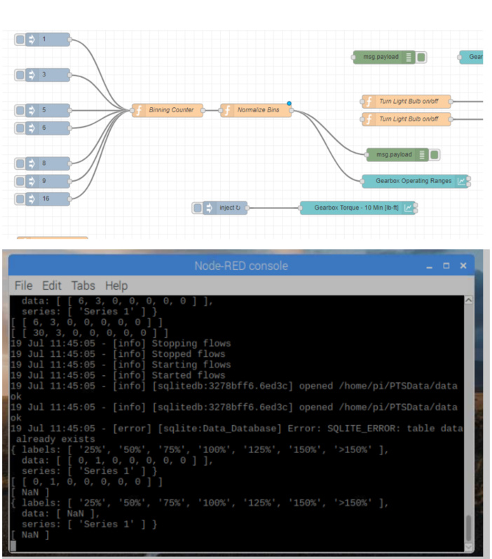

Again, everything works here. But, as soon as I add a second function node downstream to normalize the counts to 100% vs a true count the bin.data object starts to fail. (multiplied by 5 rather than dividing by total count to simplify example).
Second function block to normalize counts to 100%.
a = msg.payload.data
for(var i=0; i<a.length; i++) {
a[i] *= 5;
console.log(a)
Am I doing this the hard way? Not sure why the bin.data array is being affected at all. If I remove the "Normalize Bins" node counts increment as expected. Thanks for any advice. Zach
My console ends up looking like this.
Screenshot of nodes for reference.
