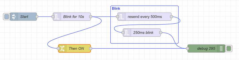

I think this should work
Edit - this is a bit more elegant
[{"id":"03129cf49825b270","type":"inject","z":"72e3ac42d134d33c","name":"Start","props":[{"p":"payload"},{"p":"topic","vt":"str"}],"repeat":"","crontab":"","once":false,"onceDelay":0.1,"topic":"","payload":"","payloadType":"date","x":190,"y":240,"wires":[["f96a76b2292e28c8"]]},{"id":"6b1863c5746ab6bd","type":"debug","z":"72e3ac42d134d33c","name":"debug 295","active":true,"tosidebar":true,"console":false,"tostatus":false,"complete":"false","statusVal":"","statusType":"auto","x":870,"y":360,"wires":[]},{"id":"f96a76b2292e28c8","type":"trigger","z":"72e3ac42d134d33c","name":"Blink for 10s","op1":"go","op2":"reset","op1type":"str","op2type":"str","duration":"10","extend":false,"overrideDelay":false,"units":"s","reset":"","bytopic":"all","topic":"topic","outputs":1,"x":370,"y":240,"wires":[["ccb505782331f0fa","8e79cb75e3504cdc"]]},{"id":"8e79cb75e3504cdc","type":"change","z":"72e3ac42d134d33c","name":"Then ON","rules":[{"t":"set","p":"payload","pt":"msg","to":"1","tot":"num"}],"action":"","property":"","from":"","to":"","reg":false,"x":380,"y":360,"wires":[["6b1863c5746ab6bd"]]},{"id":"83ca5006a975aa22","type":"group","z":"72e3ac42d134d33c","name":"Blink","style":{"label":true},"nodes":["ccb505782331f0fa","7e8d6345bf57d4ef"],"x":514,"y":199,"w":252,"h":142},{"id":"ccb505782331f0fa","type":"trigger","z":"72e3ac42d134d33c","g":"83ca5006a975aa22","name":"","op1":"1","op2":"0","op1type":"str","op2type":"str","duration":"-500","extend":false,"overrideDelay":false,"units":"ms","reset":"reset","bytopic":"all","topic":"topic","outputs":1,"x":640,"y":240,"wires":[["7e8d6345bf57d4ef"]]},{"id":"7e8d6345bf57d4ef","type":"trigger","z":"72e3ac42d134d33c","g":"83ca5006a975aa22","name":"250ms blink","op1":"1","op2":"0","op1type":"str","op2type":"str","duration":"250","extend":false,"overrideDelay":false,"units":"ms","reset":"","bytopic":"all","topic":"topic","outputs":1,"x":630,"y":300,"wires":[["6b1863c5746ab6bd"]]}]

Beautiful! Thank You!

My suggestion is not robust enough, it's possible for the last blink off to get sent after the switch node sends on.
To fix it, put a delay node set to a bit more than the on/off duration between the switch node and the output.
