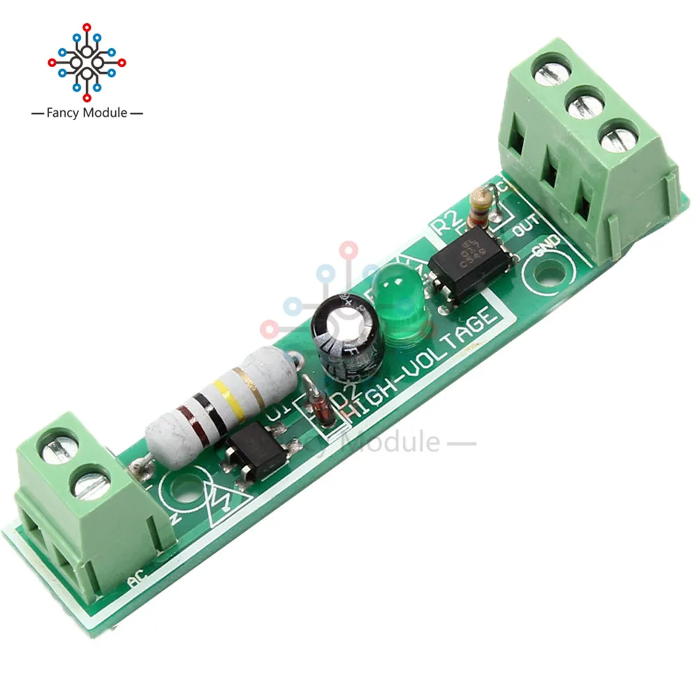

I used this optocoupler module to get a signal (feedback) from a 220V device:
