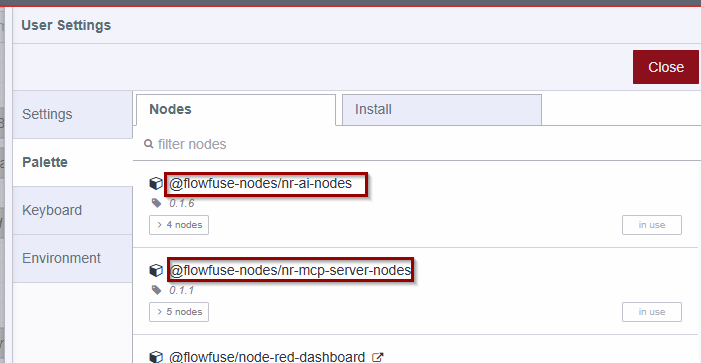

Also, please proved the exact/full names and a link to them in the library

If only I could start the editor to see the installed nodes (and their full names)? Alas, I can't and
root@DietPi:/# node-red-admin list
AggregateError
So, sorry not sure how?

You can see the names of installed nodes in the package.json file in the node-red user directory (usually ~/.node-red)
