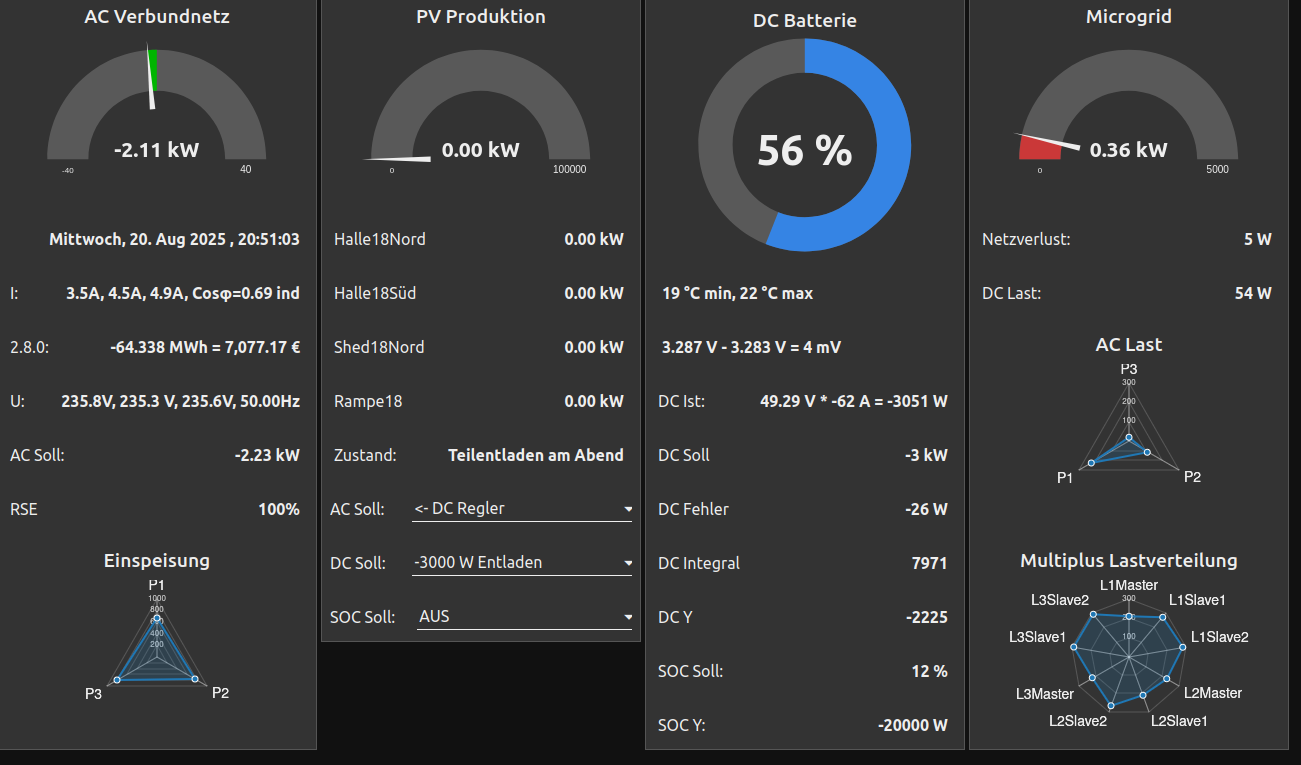

BTW: If your flow gets bigger and includes graphic visualisation dashboard and several ModbusTCP connections, you need to adjust the Cerbos hardware watchdog to avoid occasional resets. Bigger NR flows slows down the Venus System to sometimes anything like 100mS what triggers HW watchdog reset. The delays are no problem for the Cerbo but it took me some days to debug this (with the developers help of our blue friends). My Cerbo now runs really stable.
18:48:27 up 10 days, 23:30,  load average: 2.70, 3.59, 3.49
root@einstein:/etc#
NodeRed replaces the complete Victron GUI with a V1 dashboard flow for daily use. At the begining I had many doubts about NR but it really runs 24/7 very reliable.
