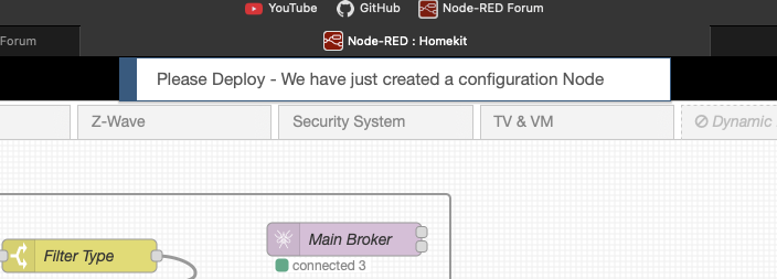

Bootstrap.html
<script type="text/javascript">
  // Instead of looping the config nodes
  let hasClient = (RED.nodes.node('Your-Config-ID') !== undefined)
  if (!hasClient) {
      // Create config
      RED.notifications.notify('Please Deploy - We have just created a configuration Node')
</script>
I use the bootstrap approach in my own Nodes - to setup side bars etc etc
