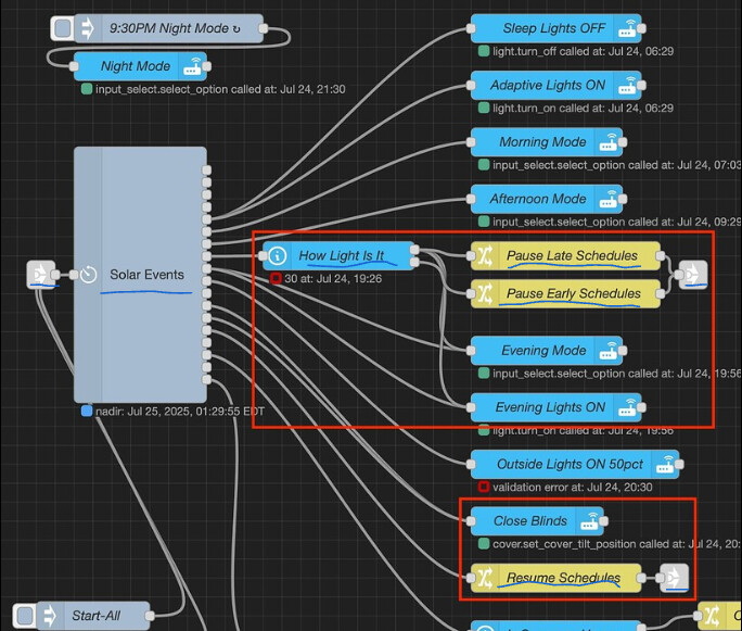

Each one of the outputs is set to a single solar event, even if I'm not using that solar event. Two of the solar events have a duplicate with a negative offset.
You can see roughly in the top outlined box, I'm using one of the duplicated solar events with the negative offset to do a check to see what the light level is currently outside. If the light outside is below a certain level, I start turning the evening lights on before they are normally supposed to, and I send a pause command for the (two) schedules that would turn the evening lights on, and close the blinds in the box below at their normal time.
If the light is above a certain level, in that early light check, it does nothing to the evening lights, and just pauses the schedule that would have closed the blinds earlier. On one of the later solar events that's scheduled, I have it set to trigger a 'start-all' command to reset the schedules every day.

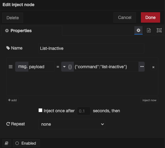

Just a simple {"command":"start-all"} being put in msg.payload, same as the way I do a 'list-inactive':

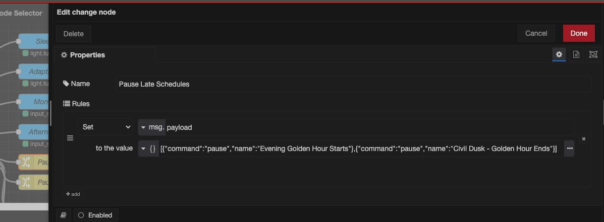

Any of the above schedules that can get paused, will not resume. To pause them, I use a change node as follows:

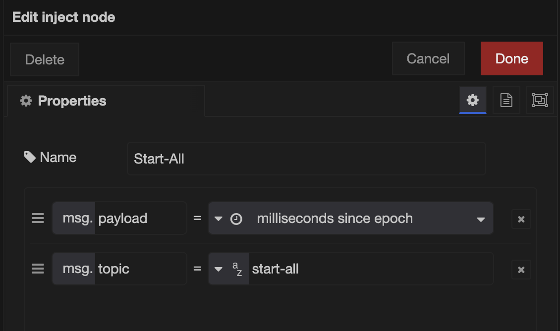

Interesting.
Unless it has been updated since I installed it and the demo scripts changed, according to the demo flow that is different.
This is what I see when I load the demo flow and open the inject node to start all schedules.
Note it is the TOPIC that says/qualified the start-all.
NOT the payload.
And I just checked. That works with what I have.
Ok, versions etc. But that is a huge change in how the node accepts commands.
Just saying.
(Also just checked. Mine is 2.1.0 cron-plus)
See, now that's exactly what I thought, and even though the pause commands work just fine the way I have it, and the 'list-inactive' works the way I have it, I wondered if maybe THEY were the bug, and maybe 'start-all' wasn't working, because I wasn't doing it precisely like that.
So I've tried all number of combos with it on the 'start-all' inject, adding it to both the msg.payload, adding it to the msg.payload AND msg.topic, doing it as JSON {}, doing it as a string with A-Z, on one, on both, with the full command, with just the actual command in quotes, without quotes.... so many different ways :smiley:
But what I haven't tried.... is precisely like you've pictured. I'll give it a go tonight, if it works, that's hilarious how the other commands work just fine the "wrong" way!

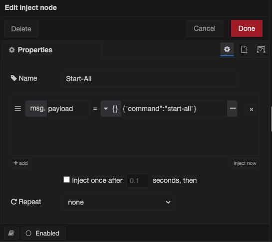

Would you believe it.... Injecting 'start-all' now works..... It reset the schedules. Doing 'list-inactive' showed me the one schedule that I expected to be inactive, then after injecting the 'start-all' and doing a 'list-inactive' again, shows the array of 0, meaning no inactive schedules.....

I manually injected a 'start-all', exactly as I did yesterday, but it didn't do anything again.... what the heck. Oh and this is the same for both my original cron-plus node, and my test cron-plus node. Neither will resume the paused schedules.
Edited to add, just tried this one as well with no luck:
I dont see anything wrong in the config.
Can you share the 8 nodes I marked with a blue line & CTRL-E export them for me pls?
I'm only seeing 5 nodes marked with a blue line.
