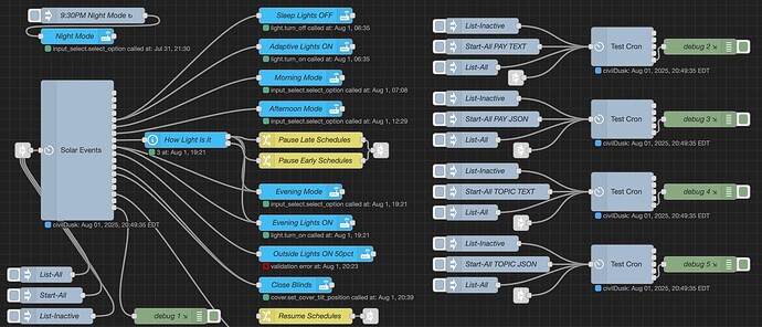

EDIT: Adding pic for clarity of where I have moved my ‘Resume Schedule’ node to.

I can resume whichever schedule(s) have been paused immediately after they were paused, but before they occur (after the red line).
But once those schedules occur/have been passed in time (pink and blue points), regardless of whether or not they are currently paused or not, they cannot be resumed in any way shape or form, without resetting the cron-plus node.

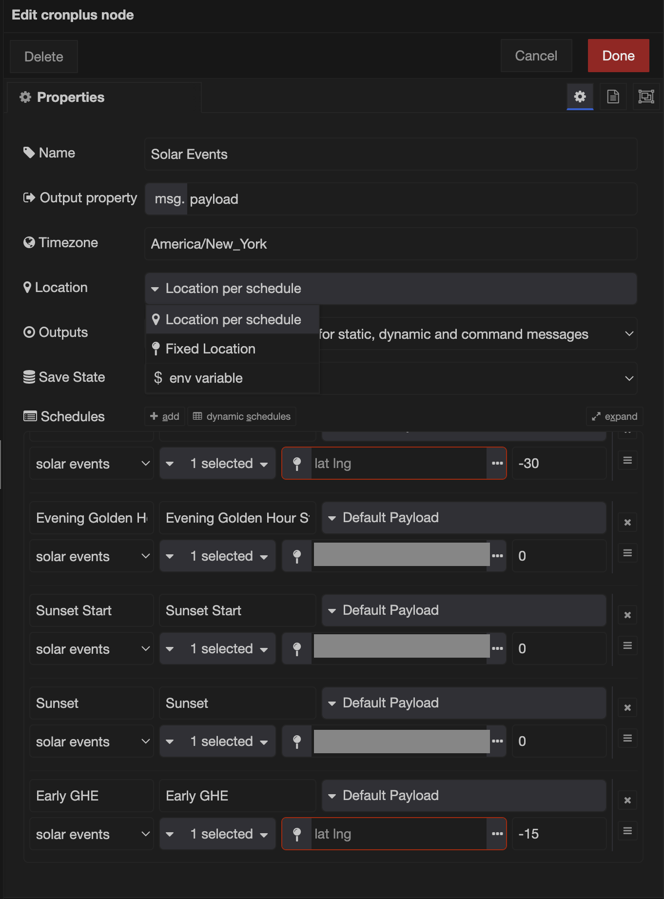

While prepping the copy, and adjusting it so I don’t give you my EXACT co-ordinates, I realised I had the location set to “Fixed Location” instead of “Location Per Schedule”, and it got me wondering, is it still storing the location per schedule anyway, and perhaps it hasn’t replicated the location for the new schedules I recently added.
Indeed, when I switched it from “Fixed Location” to “Location Per Schedule”, look what I found:
Now there were only two like this, and I’d added a total of three new schedules, but maybe I switched to “Fixed Location” mid way through adding?
Anyway, before I send you a copy Steve, I’m going to manually add the location to these two schedules and see if that helps things.
Okay, that wasn’t it, and just made things even weirder in some ways. Here’s the isolated template:
