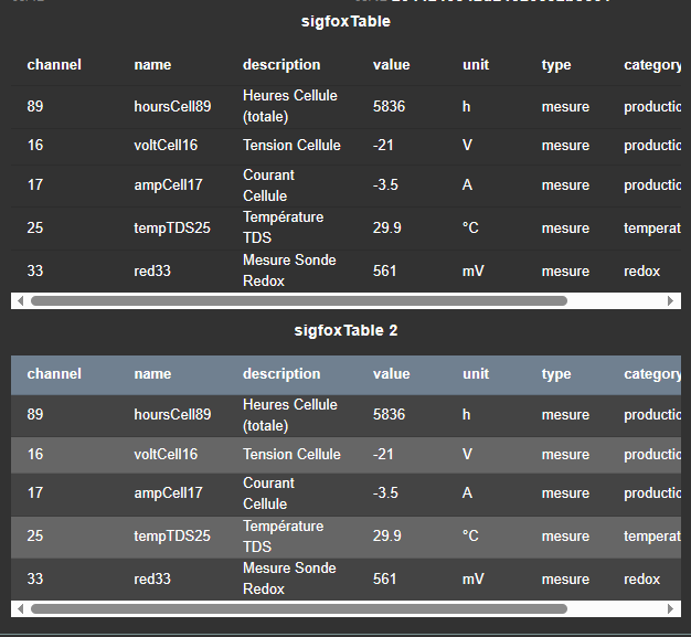

I tried applying the custom-table class in the Table node parameters, but when I click Done, it doesn't save: I can't deploy the change !?
BUT
I added the class to the "DECODE Trame" group on the "MODUL Local" page and now it works!
So the Class should not be applied to the Widget but to the Group... how then can a Class be applied only to the Widget? Since it has this property.
You are right, there seems to be a bug in the table node. The class has disappeared again if the table node is re-opened. Please submit a bug report.
Does it work if you send in a message with msg.class set to 'custom-table`?
The two tables are identical. I inject msg.class="custom-table" into the second table, and it correctly applies the CSS.
Note: I removed the custom-table class from the Class property of the group.
The <style> tags must be kept in the CSS template.
The flow:
[{"id":"86b8d9a5861f5570","type":"inject","z":"707595eff9a54cc2","name":"msg.class=\"custom-table\"","props":[{"p":"class","v":"custom-table","vt":"str"}],"repeat":"","crontab":"","once":false,"onceDelay":0.1,"topic":"","x":1530,"y":2470,"wires":[["81e53ad3f5387b6e"]]},{"id":"81e53ad3f5387b6e","type":"ui-table","z":"707595eff9a54cc2","group":"85392caa4e7f203f","name":"","label":"sigfoxTable 2","order":6,"width":0,"height":0,"maxrows":0,"passthru":false,"autocols":true,"showSearch":false,"deselect":false,"selectionType":"none","columns":[],"mobileBreakpoint":"sm","mobileBreakpointType":"defaults","action":"replace","className":"","x":1730,"y":2470,"wires":[[]]},{"id":"35d4a8e37c4f34a7","type":"ui-template","z":"707595eff9a54cc2","group":"","page":"d86f49ea355a8b97","ui":"","name":"CSS","order":5,"width":0,"height":0,"head":"","format":"<style>\n    /*==================== TABLE ==============*/\n    .custom-table thead {\n        background-color: #708090;\n        border-collapse: collapse;\n        border: 1px solid green;\n    }\n\n    .custom-table thead tr:{\n\n        border: 1px solid green;\n    }\n\n\n    .custom-table tbody tr:nth-child(odd) {\n        background-color: #444444;\n    }\n\n    .custom-table tbody tr:nth-child(even) {\n        background-color: #666666;\n    }\n</style>","storeOutMessages":true,"passthru":false,"resendOnRefresh":true,"templateScope":"widget:page","className":"","x":1720,"y":2430,"wires":[[]]},{"id":"85392caa4e7f203f","type":"ui-group","name":"DECODE trame","page":"d86f49ea355a8b97","width":6,"height":1,"order":1,"showTitle":true,"className":"","visible":"true","disabled":"false","groupType":"default"},{"id":"d86f49ea355a8b97","type":"ui-page","name":"MODUL Local","ui":"0c190d7ab5bc3c4b","path":"/page1","icon":"home","layout":"grid","theme":"8b4760c21512dfc2","breakpoints":[{"name":"Default","px":"0","cols":"3"},{"name":"Tablet","px":"576","cols":"6"},{"name":"Small Desktop","px":"768","cols":"9"},{"name":"Desktop","px":"1024","cols":"12"}],"order":1,"className":"","visible":true,"disabled":false},{"id":"0c190d7ab5bc3c4b","type":"ui-base","name":"My Dashboard","path":"/dashboard","appIcon":"","includeClientData":true,"acceptsClientConfig":["ui-notification","ui-control"],"showPathInSidebar":false,"headerContent":"page","navigationStyle":"default","titleBarStyle":"default","showReconnectNotification":true,"notificationDisplayTime":1,"showDisconnectNotification":true,"allowInstall":true},{"id":"8b4760c21512dfc2","type":"ui-theme","name":"DARK Theme","colors":{"surface":"#097479","primary":"#097479","bgPage":"#323232","groupBg":"#323232","groupOutline":"#7b9393"},"sizes":{"density":"compact","pagePadding":"12px","groupGap":"12px","groupBorderRadius":"4px","widgetGap":"12px"}},{"id":"a631751f0266a432","type":"global-config","env":[],"modules":{"@flowfuse/node-red-dashboard":"1.29.0"}}]
