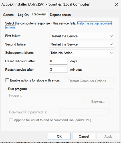

A problem I encountered when running as a service with NSSM, is that it automatically restarts the Node-RED server process upon crash. Hence the process may be constantly crashing & restarting without me knowing about it.
Does anyone know how to control this?
Open the Windows Services tool, find the nssm Node-RED service and double-click. Then go to the Recovery tab:
You can control everything from there. You can even run another programme on error failure. You could use an AutoHotKey script to show a dialog box for example.
