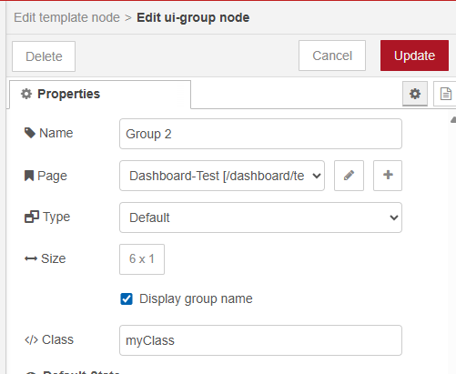

  1. I add a UI-template with Type: CSS (All Pages)
.miclase {
    color: red;
  1. In the UI-group, in the Class field, I add the name of my custom class (miclase).
My goal is to change the group's background color from a Boolean value passed in the flow.

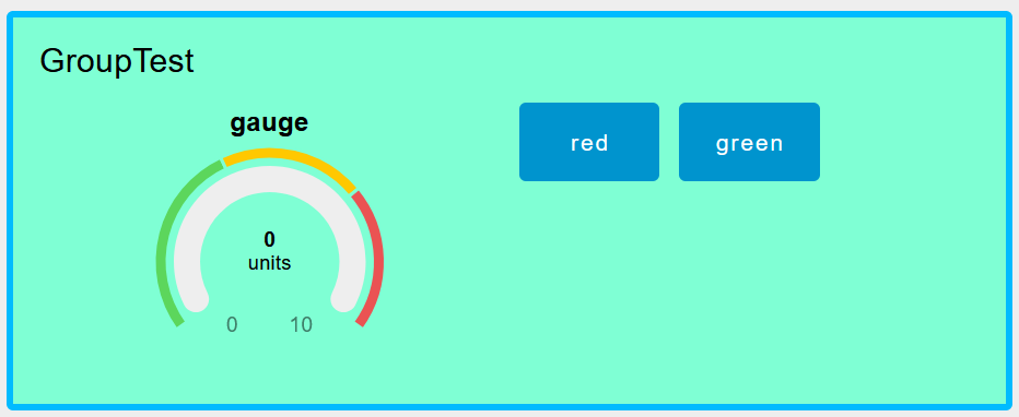

Try this
.myClass .v-card.bg-group-background{
    background-color: aquamarine !important;
    border: 4px solid rgb(0, 187, 255);
This way it worked, thanks a lot!!

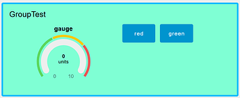

You can also achieve it by changing that CSS variable --v-theme-group-background
    --v-theme-group-background: 127, 255, 212;
(127,255,212 is the rgb values for aquamarine)
I notice that this approach does not need !important so I guess it's better but I don't like having those 3 magic numbers without a clear explanation of what they do, in contrast to the border declaration.

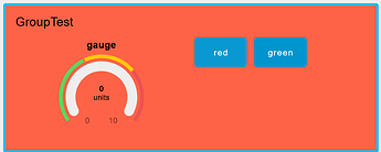

This seems to work
[{"id":"c884071357627e5c","type":"ui-gauge","z":"768d2e6b4a117398","name":"Test 1","group":"2bf45d898cab6025","order":1,"value":"payload","valueType":"msg","width":3,"height":3,"gtype":"gauge-34","gstyle":"rounded","title":"gauge","units":"units","icon":"","prefix":"","suffix":"","segments":[{"from":"0","color":"#5cd65c"},{"from":"4","color":"#ffc800"},{"from":"7","color":"#ea5353"}],"min":0,"max":10,"sizeThickness":16,"sizeGap":4,"sizeKeyThickness":8,"styleRounded":true,"styleGlow":false,"className":"trigger","x":610,"y":240,"wires":[]},{"id":"f6ed848e6f96a4f5","type":"ui-template","z":"768d2e6b4a117398","group":"","page":"b3ca132d0792292e","ui":"","name":"estilo","order":0,"width":0,"height":0,"head":"","format":".myClass .v-card.bg-group-background{\n    border: 4px solid rgb(0, 187, 255); \n    /* this is the colour if neither green nor red is set */\n    --v-theme-group-background: 222, 184, 135;\n}\n\n.myClass:has(.green) .bg-group-background{\n  --v-theme-group-background: 127, 255, 212;\n}\n.myClass:has(.red) .bg-group-background {\n  --v-theme-group-background: 255, 99, 71\n}","storeOutMessages":true,"passthru":true,"resendOnRefresh":true,"templateScope":"page:style","className":"","x":610,"y":200,"wires":[[]]},{"id":"3de5e142b26d13fe","type":"inject","z":"768d2e6b4a117398","name":"","props":[{"p":"payload"},{"p":"topic","vt":"str"}],"repeat":"","crontab":"","once":false,"onceDelay":0.1,"topic":"","payload":"4","payloadType":"num","x":150,"y":240,"wires":[["c884071357627e5c"]]},{"id":"a53524c1ceccc021","type":"ui-button","z":"768d2e6b4a117398","group":"2bf45d898cab6025","name":"Red","label":"red","order":0,"width":"1","height":"1","emulateClick":false,"tooltip":"","color":"","bgcolor":"","className":"","icon":"","iconPosition":"left","payload":"red","payloadType":"str","topic":"topic","topicType":"msg","buttonColor":"","textColor":"","iconColor":"","enableClick":true,"enablePointerdown":false,"pointerdownPayload":"","pointerdownPayloadType":"str","enablePointerup":false,"pointerupPayload":"","pointerupPayloadType":"str","x":130,"y":280,"wires":[["63e47fa45ce550fe"]]},{"id":"17f68243bed3b672","type":"ui-button","z":"768d2e6b4a117398","group":"2bf45d898cab6025","name":"Green","label":"green","order":0,"width":"1","height":"1","emulateClick":false,"tooltip":"","color":"","bgcolor":"","className":"","icon":"","iconPosition":"left","payload":"green","payloadType":"str","topic":"topic","topicType":"msg","buttonColor":"","textColor":"","iconColor":"","enableClick":true,"enablePointerdown":false,"pointerdownPayload":"","pointerdownPayloadType":"str","enablePointerup":false,"pointerupPayload":"","pointerupPayloadType":"str","x":130,"y":320,"wires":[["63e47fa45ce550fe"]]},{"id":"63e47fa45ce550fe","type":"function","z":"768d2e6b4a117398","name":"Set the class of a widget in the group","func":"let newmsg = {\n    \"ui_update\": {\n        \"class\": msg.payload\n    }\n}\nreturn newmsg;","outputs":1,"timeout":0,"noerr":0,"initialize":"","finalize":"","libs":[],"x":370,"y":300,"wires":[["c884071357627e5c"]]},{"id":"2bf45d898cab6025","type":"ui-group","name":"GroupTest","page":"b3ca132d0792292e","width":"6","height":"1","order":1,"showTitle":true,"className":"myClass","visible":"true","disabled":"false","groupType":"default"},{"id":"b3ca132d0792292e","type":"ui-page","name":"Test","ui":"e9c974f7c1d080d1","path":"/test","icon":"home","layout":"grid","theme":"c835807cdc98644e","breakpoints":[{"name":"Default","px":"0","cols":"3"},{"name":"Tablet","px":"576","cols":"6"},{"name":"Small Desktop","px":"768","cols":"9"},{"name":"Desktop","px":"1024","cols":"12"}],"order":13,"className":"","visible":"true","disabled":"false"},{"id":"e9c974f7c1d080d1","type":"ui-base","name":"My Dashboard","path":"/dashboard","appIcon":"","includeClientData":true,"acceptsClientConfig":["ui-notification","ui-control"],"showPathInSidebar":false,"headerContent":"page","navigationStyle":"default","titleBarStyle":"default","showReconnectNotification":true,"notificationDisplayTime":1,"showDisconnectNotification":true,"allowInstall":true},{"id":"c835807cdc98644e","type":"ui-theme","name":"Default Theme","colors":{"surface":"#ffffff","primary":"#0094CE","bgPage":"#eeeeee","groupBg":"#ffffff","groupOutline":"#cccccc"},"sizes":{"density":"default","pagePadding":"12px","groupGap":"12px","groupBorderRadius":"4px","widgetGap":"12px"}},{"id":"40578943acc9d562","type":"global-config","env":[],"modules":{"@flowfuse/node-red-dashboard":"1.25.0"}}]
