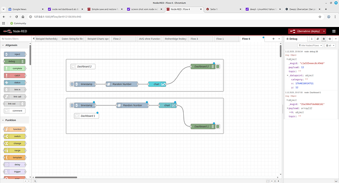

but for deep dive it clear that the dasboard 2 so massiv the datastucure has changed but how ?
Yes i have read the GIT HUB but is absolut mis understanding…
also how works vom any chart the array to any log file what is teh difrrenz? In dashboard 1 it was so easy ,_9
It look so clear and easy for dashboard 1 !
