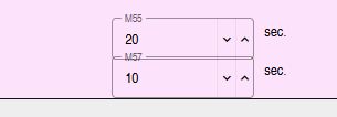

I want to put into Dashboard 2.0 page several numer input fields below each other. But the number input field`s height is larger than the line height, so the fields overlap.
Is there a way to adjust this?

Check the Widget Gap in the theme you have specified for the page, I suspect you may have shrunk it down too much.
Assuming that it is the theme then if you add a ui-template node to your flow, configured in CSS mode, containing this then that should sort it for text input nodes and dropdown nodes too.

@Colin: You were right, it was the widget gap.
