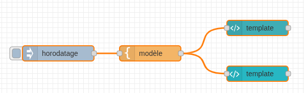

Here is my flow, very simple
one template is for dashboard v1 : it contains
<div ng-bind-html="msg.payload"></div>
this is the result
the other template is for dashboard v2, it contains
<template>
    {{ msg.payload }}
</template>
this is the result
If template for dashboard 2 contains
<template>
</template>
nothing is printed !
So they do not work exactly in the same way !
Or what did I do wrong ?
