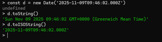

if msg.payload.last_seen really is a string containing exactly 2025-11-09T09:46:02.000Z then there is no reason that wouldn't work
Proof in Node REPL:
So something is not quite right. either the path is wrong or its not actually a string or...

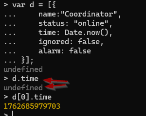

When I construct my device table from scratch I have another function to initialise only my zigbee coordinator like
var d = [{
    status: "online",
    time: Date.now(),
    ignored: false,
    alarm: false
global.set("devices",d)
This works as expected. the d.time is a date object. All other devices added with the function above are not.
The DateConstructor has 3 overloads. Could that be a reason?
d is an array. it will never be able to reveal the value of an inner element. d[0].time will.
