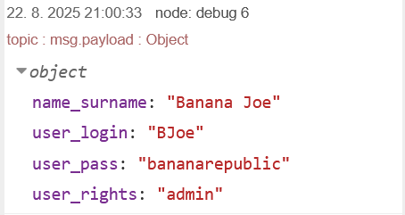

Put a debug node on the output of your ui-form node to check what you are getting out of it.
@Buckskin screen from directly connected debug :
