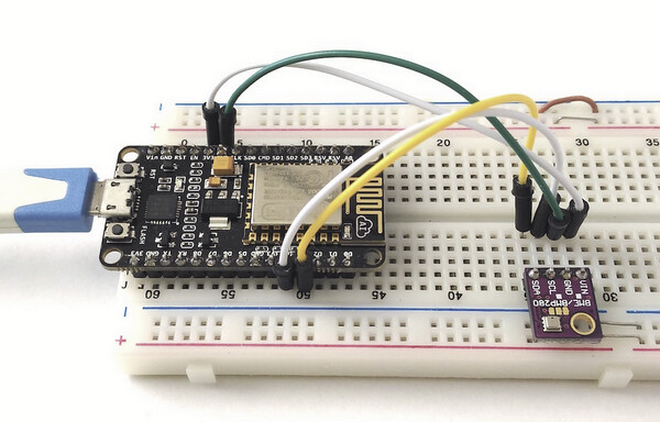

Many people choose to break this task down into seperate pieces:
  1. Connect your BME280 to an ESP8266 microcontroller, not directly connected to your Node-red system.
    If you run Tasmota on the ESP8266, this will give you a web based console like this (mine is a BME680. A BME280 would be the same without "Gas")
  2. Tasmota sends the data to Node-red using MQTT, so you need an MQTT broker. A very good choice is Mosquitto.
    Here is a very simple flow showing the BME data arriving in Node-red.
  3. Process the data in Node-red
There are good tutorials in this forum and on the web for these stages.
