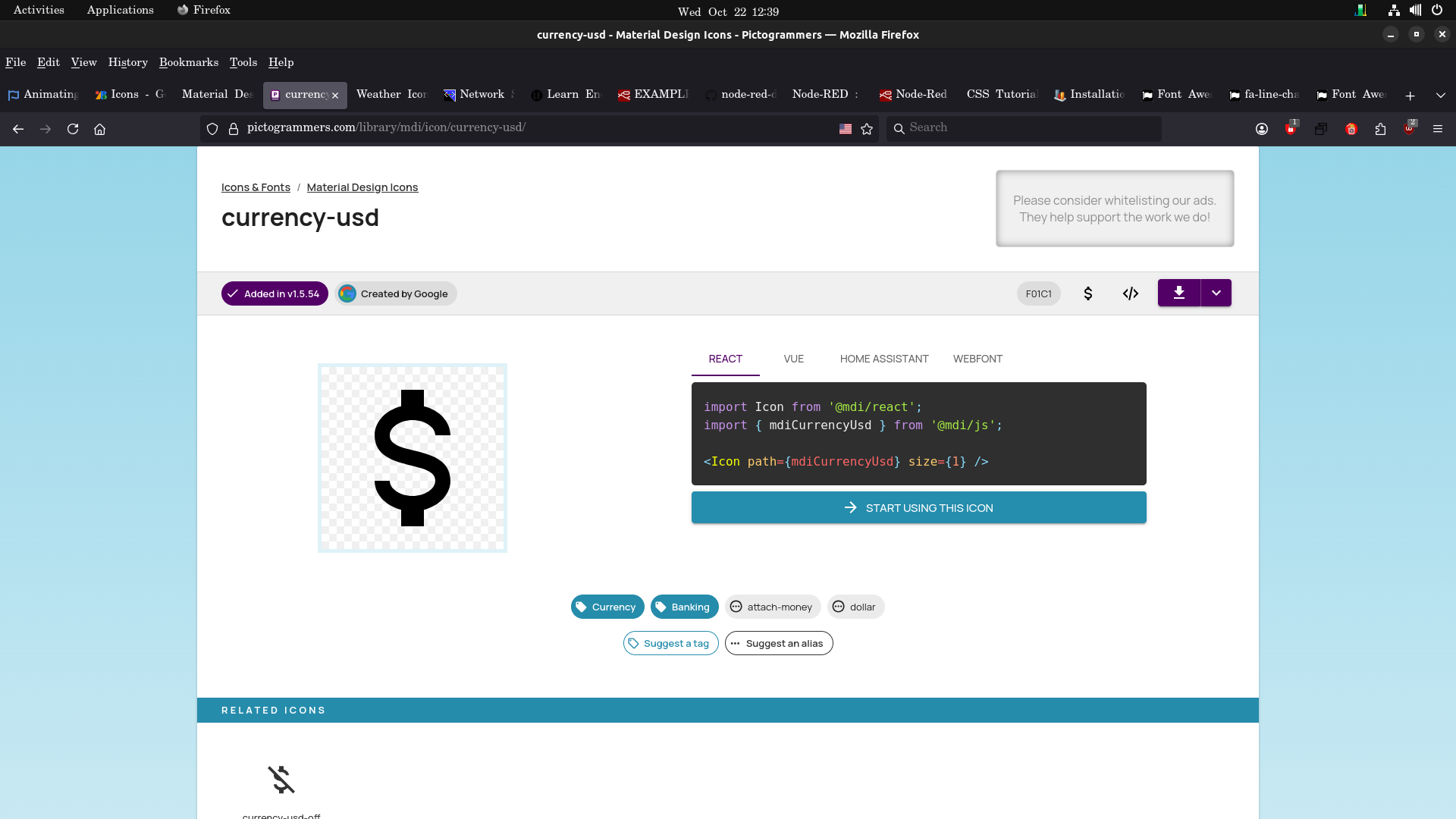

This is what is shown on THE web page for the icon and what it should look like.
And yet, this is what it looks like on my dashboard:

I've since found out that that Big number is the SVG for the icon.
That big number looks exactly like the image you have in your button, so nothing is wrong except that you have the wrong "big number"
Where did you get it from, I suspect you clicked the wrong icon ?
