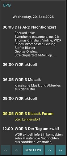

I’m trying to scroll automatically to a specific row in a html-table, displayed with the template. Usually this is no problem, when you mark each row with <div> and use a little JS in the head section - but the dashboard seems to filter such marks. It also deletes marks such as …
Now it’s looking this way:
But I want it to display this way:
Any suggestions how to fix this? :slightly_smiling_face:
