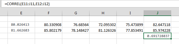

What formula are you using to calculate the correlation?
https://support.microsoft.com/en-us/office/correl-function-995dcef7-0c0a-4bed-a3fb-239d7b68ca92

You can do Pearson correlation in a simple function node.
[{"id":"95281ed3cac1ab80","type":"function","z":"eb3bd3ff.33367","name":"pearsonCorrelation","func":"\n\n\nmsg.payload = pearsonCorrelation(msg.a1, msg.a2);\n\nreturn msg;\n\n\nfunction pearsonCorrelation(x, y) {\n    let n = x.length\n    const promedio = l => l.reduce((s, a) => s + a, 0) / l.length\n    const calc = (v, prom) => Math.sqrt(v.reduce((s, a) => (s + a * a), 0) - n * prom * prom)\n    let nn = 0\n    for (let i = 0; i < n; i++, nn++) {\n        if ((!x[i] && x[i] !== 0) || (!y[i] && y[i] !== 0)) {\n            nn--\n            continue\n        }\n        x[nn] = x[i]\n        y[nn] = y[i]\n    }\n    if (n !== nn) {\n        x = x.splice(0, nn)\n        y = y.splice(0, nn)\n        n = nn\n    }\n    const prom_x = promedio(x), prom_y = promedio(y)\n    return (x\n        .map((e, i) => ({ x: e, y: y[i] }))\n        .reduce((v, a) => v + a.x * a.y, 0) - n * prom_x * prom_y\n    ) / (calc(x, prom_x) * calc(y, prom_y))\n}","outputs":1,"noerr":0,"initialize":"","finalize":"","libs":[],"x":1330,"y":180,"wires":[["e727ff500b4071ec"]]},{"id":"669a260113301fa7","type":"inject","z":"eb3bd3ff.33367","name":"inject msg.a1 and msg.a2","props":[{"p":"a1","v":"[80.026413,80.330908,76.68564,72.095302,75.473899,82.647118]","vt":"json"},{"p":"a2","v":"[81.662683,85.802179,78.148427,81.126326,77.853491,85.974228]","vt":"json"}],"repeat":"","crontab":"","once":false,"onceDelay":0.1,"topic":"","x":1290,"y":120,"wires":[["95281ed3cac1ab80"]]},{"id":"e727ff500b4071ec","type":"debug","z":"eb3bd3ff.33367","name":"","active":true,"tosidebar":true,"console":false,"tostatus":true,"complete":"true","targetType":"full","statusVal":"payload","statusType":"msg","x":1370,"y":240,"wires":[]}]
