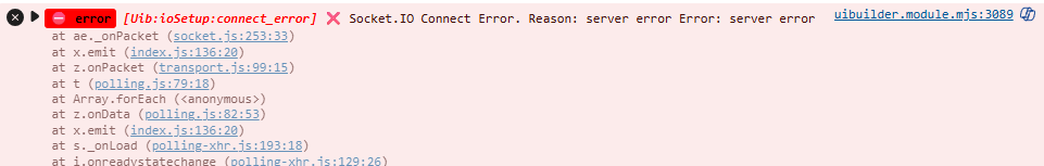

when access devtool at react dev mode 3000, i see error that it call (http://localhost:3000/uibuilder/vendor/socket.io/?EIO=4&transport=polling&t=s39g92b8)
1880 work, but 3000 return ...
while I set script is <script src="http://localhost:1880/uibuilder/uibuilder.iife.min.js"></script>.
I already set proxy too but not work...

Looking at your screenshots, clear that the client cannot connect to the socket.io server.
