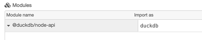

Assuming the following import:
Function:
const instance = await duckdb.DuckDBInstance.create('my_duckdb.db');
node.warn({instance})
debug result:
{"instance":{"db":{}}}
and the my_duckdb.db has been created in my homepath.
Now, when you try to connect with DuckDB CLI to my_duckdb.db, you get:
Error: unable to open database "my_duckdb.db": IO Error: File is already open in node.exe
How can I close the database without shutting down Node-RED/Node.exe?
The documentation states:
Multiple instances in the same process should not attach the same database.
As the db is already created, you can use the cache method:
const instance = await duckdb.DuckDBInstance.fromCache('my_duckdb.db');
const connection = await instance.connect();
node.warn({connection})
connection.closeSync();
return null
