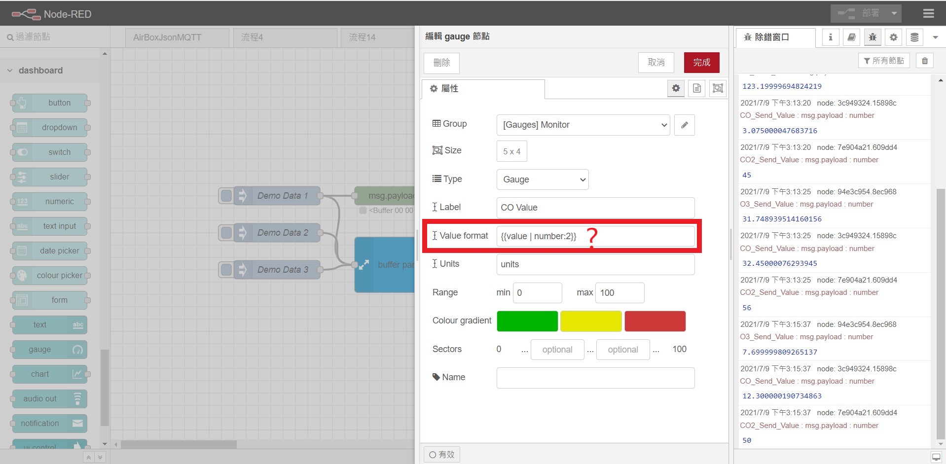

If I have 1 input but multi output...How to do?
Dear McI :
  1. If I receive is done so send ok else send bad.
  2. Look at pic :
    {{value | number:2}} //What its mean?
Thank u.
It means format msg.payload to a number with 2 decimal points.
Read the built in help...
Dear Steve-Mcl :
  1. {{value | number:2}} But no round the value to two decimal place?
  2. Cause need show some information So if use my way is can to do?
Thank u.
You can see from the demo I gave you is DOES round...
What is "some information"?
I'm afraid much of what you write makes no sense. I realise English is not your first language, so you might be better off using your own language and google translate?
