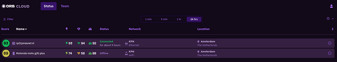

As a test I installed a Orb sensor on a Raspberry Pi 3B. This Pi runs Raspberry Pi OS Bookworm. Installation was fast and without any issues. After registering an account, you can log in to https://cloud.orb.net/status
I also installed the app from the play store om my Android phone.
It turns out that the app also contains a sensor as, the phone showed up in the Dashboud after installation.
Below a screenshot for the orb cloud website.
In my opinion, it does not offer much, except an overview of the installed sensors.

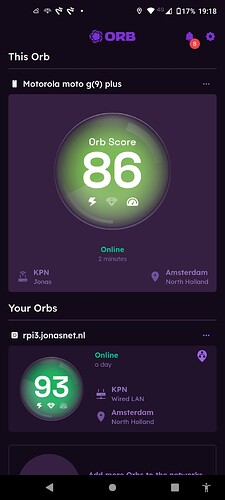

The app on the phone gives you more information.
See the screenshots below:
This shows us Responsiveness and Reliability. But what does that mean.
Currently I do not have a feeling about it.
It shows also the Download and Upload speed of the device.
Not bad, for a Pi 3B, which has an 100Mb Ethernet port (wired)
I shows “Lag” as well, 2 ms to the router and 6 ms to Internet.
Obviously 2 + 6 = 8 and that results in a score of 92 (100 - 8)>

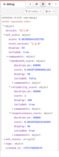

I didn’t give up and did some more research.
I installed a sensor on a Raspberry Pi 3B and it turned out that an application has been installed for the user “orb”. In its home directory you will find a number of hidden files and a hidden config directory.
An orb executable exist and with the following options, you will receive data:
Orb: Measure what matters (``orb.net``)
Usage:
orb [command]
Available Commands:
sensor Run the Orb sensor
listen Connect to a running Orb service
link Link this Orb to an account
version Current version of Orb
summary Show the latest summary for this Orb
help This screen
Flags:
-h, --help help for example
-r --remote connect to remote host
I also found the Home Assistant add-on source code and they do exactly what I thought.
They push orb summary to MQTT. They do it even every 5 seconds. I.m.o too much.
I have the orb sensor on the same Pi and an instance of Node RED.
So a simple exec node with the above command does the job.
To be a little more flexible, I created a simple bash script, that pushes the result to MQTT.
Next step is to find, what the values really represent and what is their meaning.
In HA users are very enthusiastic, but I have to understand where I look at.
To be continued. :slightly_smiling_face:
