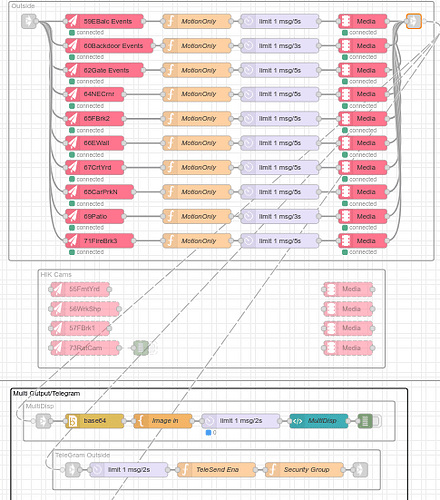

This is what I have done/found out based on @BartButenaers Onvif utilities:
1 Use onvif-events node to start and stop monitoring of a single/multiple camera(s)
2 Use onvif-events node to monitor changes on the active camera(s) and use the output of this node to trigger a response.
3 I am using this trigger to read a snapshot from the camera using the onvif-media node.
4 this is then fed into:
5Screenshot_20251024_104030
6 Multiple cameras point to this little string, giving me snaps of motion detection as they come up...
I am not interested at this stage to have live video streams, as the camera subsystem is hooked to an NVR to cater for that side...
This is a reasonably low horsepower and bandwidth utility to just highlight places of interest on my security system at a glance...
