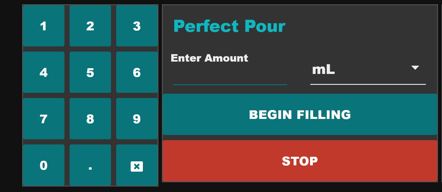

I made a little keypad out of buttons in Dashboard, and I'm simply trying to set it up so when you click 1, it sends out the "1", then 2, it would send "12", then 3, it sends out "123", and so on.
The way I have set up now works; using the "file" node and the "file in", appending each input and sending it, then the little X button there overwrites the file with nothing so you can start again from scratch. It works OK, but it feels inelegant, and there's also a small delay in the output sometimes, so I'm wondering if that's because of this method.
