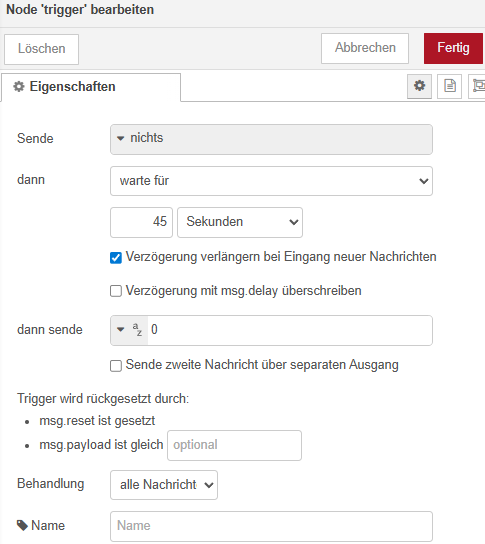

Trigger looks so:
So messages are continuing to be received by the MQTT node, but the value doesn't change?
You can put a filter node between mqtt and trigger to remove duplicates.
Make sure that the trigger time is more than twice the normal message frequency so that occasional valid duplicates don't trigger the reset.

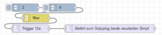

I tried your proposal with easy inject nodes and reduced time:
It works with the testing nodes :wink: I hope it works also if the failure comes again.
