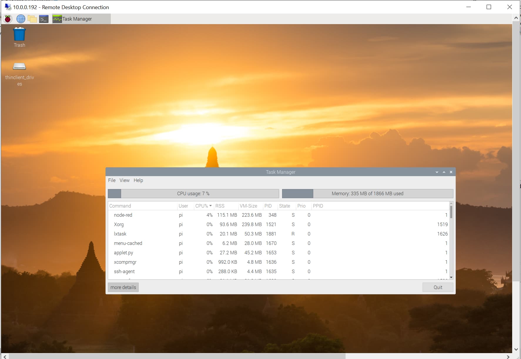

Please show us exactly where you are seeing the memory increase. On linux memory usage can be confusing. I don't know that task manager so please show us the whole display.
Top right of the task manager shows memory usage.
Task manager is "LXTask 0.1.9"
I don't think that tells you anything very useful. Instead use the command top or htop and see what they show.

Sorry, I thought the task manager showed KB but it is MB, so about 1 MB per minute.
At that rate, if it were a real memory leak you would be in trouble long before three days were up. As dceejay suggests, you will probably find it stabilises after a number of hours when the garbage collection kicks in.
