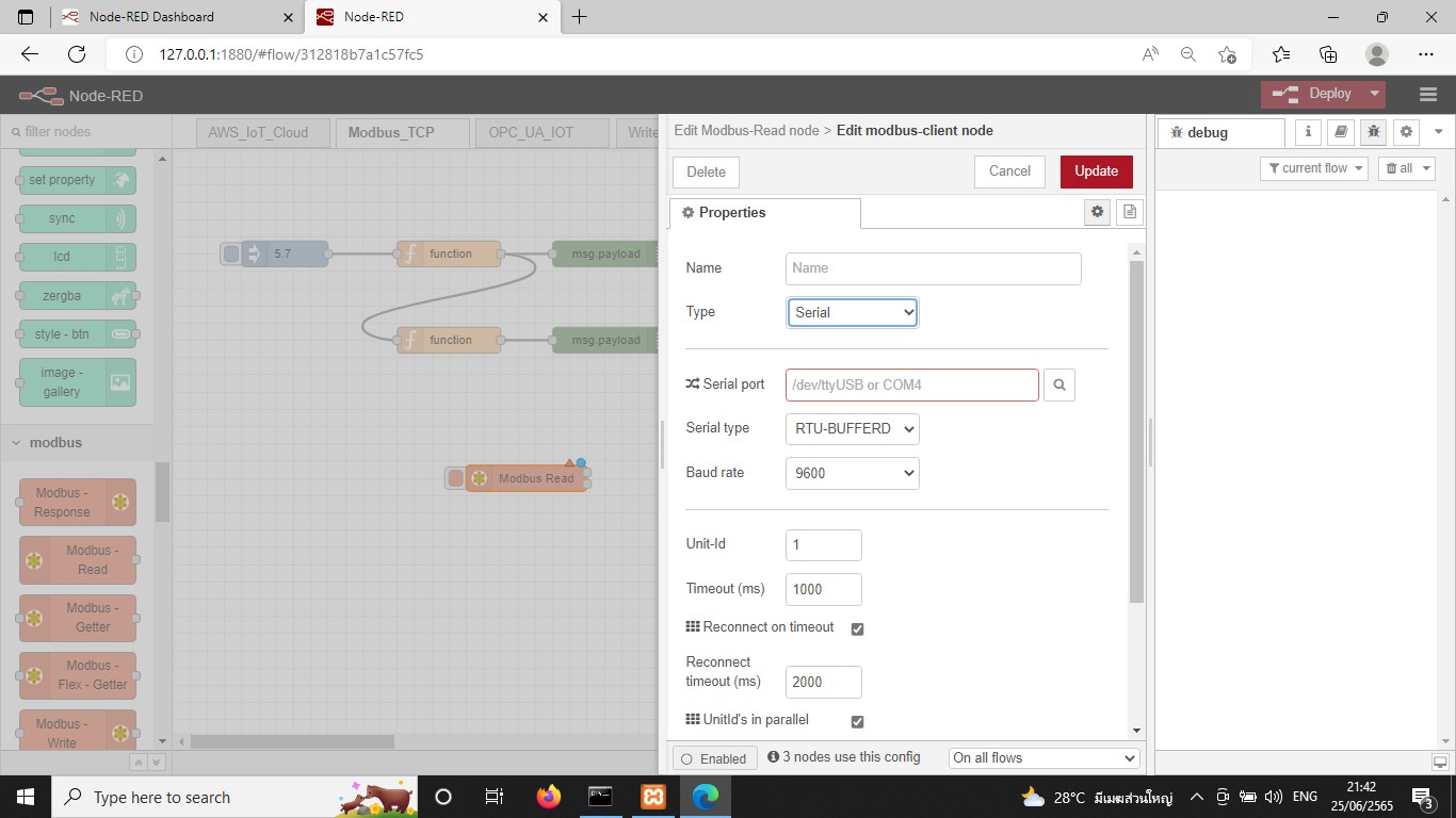

Hi every one I have a problem with modbus serial below
how can I fix it node version 16.15.1 npm version 8.13.1 thank.
