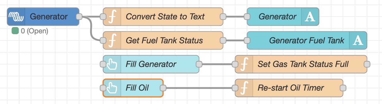

I've got several flows and I've just started cobbling together a dashboard.
On my dashboard flow that I use to populate the dashboard, I have a stand alone function that I use to call a global context GasTankStatus, so that I can put the status of the tank (empty or not empty) on my dashboard. I know the Global Context is there and I have the right path.
But when I use the function to try to get it and then send it along to a Dashboard Text module, I'm being told msg is undefined.
Since nothing is calling this function with a message, I figure I should just declare a msg in the ON START tab and send it that way. But when I try, it tells me MSG is already defined. But if I don't declare it there and have it send, the debug tells me it's undefined.
I imagine this function might only fire once since it's not receiving a message (and I don't know if it fires every 5 seconds or not, so it may not achieve what I am trying to do) but I'd like to know why I can't get it to send anything to the text module.

That's what I would have thought as well. But when I just tried msg.payload = "EMPTY" it would then result in that debug error of msg not defined. But if I tried to define it in there as a var then it said it was already there. So it was a Catch 22.
Instead of having the function floating by itself (nothing feeding into it), I just tied it into an existing node and did it that way. Now it works.
