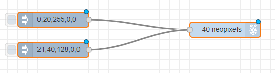

If you look in the node info its says
so as an example you could send
0,20,255,0,0 to send bright red to pixels 0-20
and then send
21,40,128,0,0
to set the bathroom pixels to half brightness red
test setup
[{"id":"f4307f68.ab07c","type":"inject","z":"d2f9050.da35df8","name":"","topic":"","payload":"0,20,255,0,0","payloadType":"str","repeat":"","crontab":"","once":false,"onceDelay":0.1,"x":470,"y":160,"wires":[["a63b9f97.119bc"]]},{"id":"ff8720d0.e3cf2","type":"inject","z":"d2f9050.da35df8","name":"","topic":"","payload":"21,40,128,0,0","payloadType":"str","repeat":"","crontab":"","once":false,"onceDelay":0.1,"x":470,"y":220,"wires":[["a63b9f97.119bc"]]},{"id":"a63b9f97.119bc","type":"rpi-neopixels","z":"d2f9050.da35df8","name":"","pixels":"40","bgnd":"","fgnd":"","wipe":"40","mode":"pixels","rgb":"rgb","brightness":"100","gamma":false,"x":810,"y":180,"wires":[]}]
