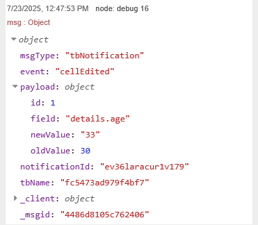

If I edit Name (cell edit) on the dashboard and refresh the browser the new value sticks and also appears after refresh for other clients. If I Edit Age or Gender the new value disappear after refresh. The node on the server side does emit a "cellEdited" event:
