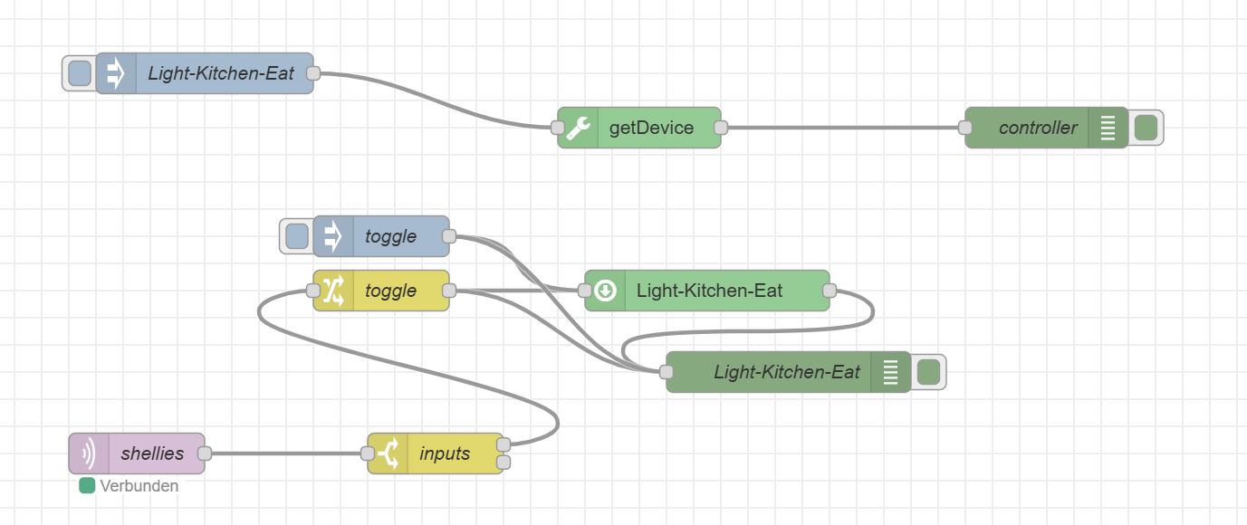

My solution: I've attached a shelly mini behind each switch and configured the shelly to disconnect the physical switch input from its relais; then I wanted to connect each lamp/light-bulb with a secondary matter-controller, using node-red-matter-controller and use the switch-input from the shelly to send a toggle command to the lamp/lightbulb when the switch input from the shelly changes (using mqtt for that integration).

  3. I had a test flow running, with a single light bulb (a new IKEA MATTER bulb) and integrated the shelly input via mqtt, being able to send toggle commands to the light bulb, either via inject node or via the shelly input. This was doing fine for the last week.

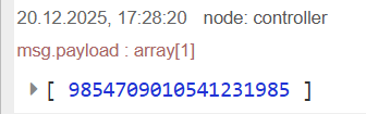

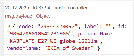

    • after a "get device" operation inside the DeviceManager Node, the Node reported the device details just fine
      ... and the toggle command suddenly started working again :zany_face:

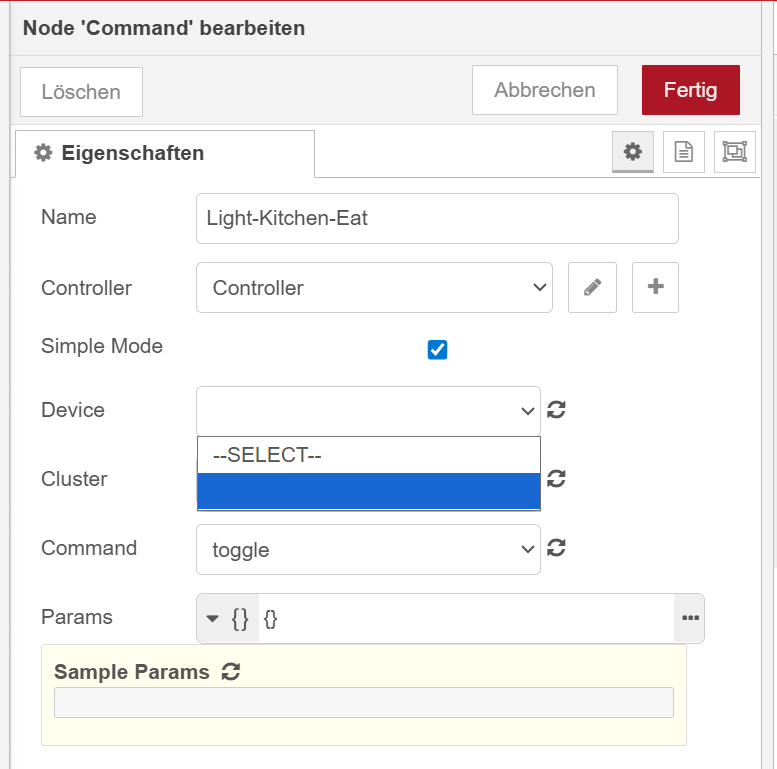

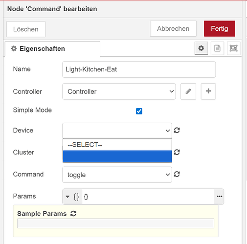

    • in the command node, however, the device is not listed anymore
      (although the command for the formerly configured device still works) :grimacing:

Just to check - you did select the circle arrows to update the Device & Cluster dropdowns?
I also think that once the Controller has been connected to Matter you cannot change the name. I seem to remember reading about it but I cannot find where. There are a few discussions about the Matter controller & bridge if you search the forum with Matter
Yes, I used the circles, after I first ran the commissioning sequence on the Controller.
By then, everything was there/selectable, but not after the glitch with the power loss and restart/get devices run on the VM later.
