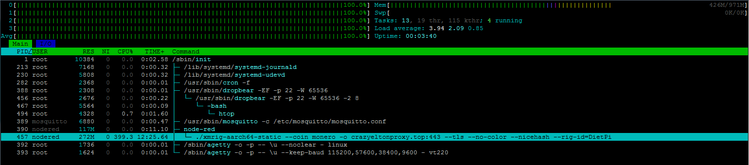

Node Red starts mining Monero coins without my consent!
I noticed that Node red has started mining Monero cryptocurrency without my knowledge and permission. I remove the process in htop but after deploying the flow in Node red it reappears. How did this happen?

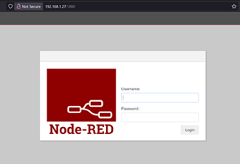

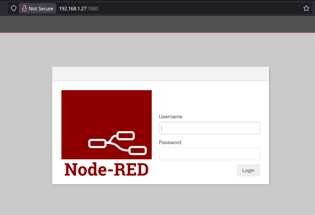

You can setup a username and password for the Node-red editor.
Then at login you should see this screen
I think that most cases we have seen of hacked Node-red did not have this setup.
A hacker who gets this far knows you have Node-red but they have to guess user names and passwords.
There is nothing in Node-red to respond to many failed login attempts, so they could keep trying different combinations over an extended period.
So I wondered if your user name was one commonly guessed eg "root", "admin", "nodered".
If not, it seems likely that the attacker already knew your user name and password.
