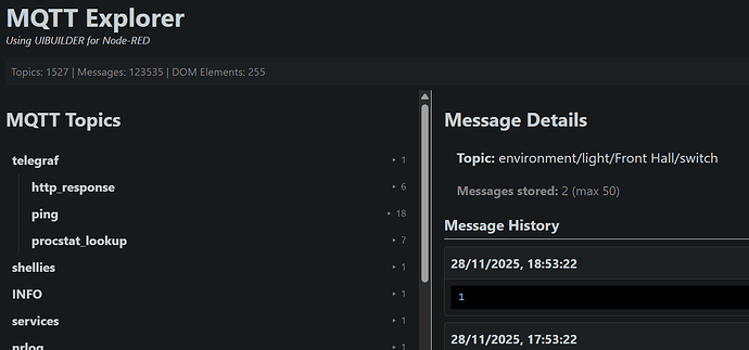

Urm, unexpectedly and thanks to the inclusion of Claude Opus 4.5 in VSCode/GitHut Copilot, I've now also uploaded a complete rewrite!
Version 2025-11-28-a should cater for 10's of thousands of topics, each with 10 historic values! Far better than the previous version. In fact, Copilot tells me that it should be able to deal with over 100,000 topics! :exploding_head: I will leave it running now to see how it copes.
There is also a CHANGELOG file so you can see what is changing as I go along.
:face_with_spiral_eyes: Oops, just blew up Node-RED!
Seems that my dev PC really doesn't want to handle 200k MQTT messages PER SECOND! Who would have guessed! :rofl:
Maybe I should add in an option to let the browser go direct to MQTT instead?
Quick update. I left my explorer tab going overnight and right up till just now:
Page stats:
So I recon the new approach is stable and capable of handling high workloads. This example includes everything in my MQTT broker excepting two topics that record detailed trace logs from UIBUILDER - that broke Node-RED last time - obvious in hindsight since outputting those triggers an ever-growing cascade of trace messages from the uibuilder node the messages are going through. :face_with_spiral_eyes:
I recon being able to handle over 200,000 topics and nearly 300,000 messages is pretty good. CPU occasionally spikes to maybe 7% on a sudden influx of messages but mostly is running 0-0.1% and the heap size is certainly manageable.
This was set to keep 50 messages per topic to the 46MB should now be pretty stable.
There should be a new full version out tomorrow with a comprehensive flow and the updated front-end which is now closer to the Explorer app and has the ability to publish messages. It should also have the MQTT v5 properties added.

Please try the new version that I've just pushed to GitHub! It has various improvements and most notably is now MUCH better at handling extremely large numbers of topics. Though folk should note that it can take an appreciable amount of time for Node-RED to send all the messages and for the browser to receive and process them - nearly 3 minutes on my dev PC with 83.5k topics and just under 83k messages,
This is, I believe a really good example of the performance overheads of Node-RED vs a more direct node.js (the original MQTT Explorer uses Electron with direct use of the mqtt node.js library). The original MQTT Explorer app is able to load the same or more data in a few seconds.
I'm also noting some inconsistencies when using Node-RED's MQTT nodes - such as $SYS not consistently loading, especially when using dynamic configurations. I want to do a separate set of tests using the MQTT library direct into a function node to see home much difference that makes.
To update your front-end code, simply re-apply the template as described in the first post. It will overwrite everything so if you made any changes, don't forget to take a copy first.

I have updated to the latest version.
It seems that after having scrolled down to a level of sub topics, the display is more or less frozen to the existing topics at the time of scrolled down.
Not sure it is 100% clear... Said otherwise, no new topics are displayed when the view is "open" see below:
The "historical" MQTT explorer shows much more subtopics...
Darn it, something has gone wrong again. I must have let a regression creep in. I can see that during the initial page load, I'm getting 50% CPU and 90k+ DOM notes which isn't right.
Actually, I think it may be worse than that! The subtopic count increases but you are right, and actually even if closed, the new topic isn't appearing for some reason. Once a topic has been opened, it is not added to.
The display only shows the count for the 1st child level. That is not the same as the app which shows the count for ALL sub-topic levels combined. I don't like that as I don't think it is the best UI.
Fixed in UIBUILDER v7.6.0
