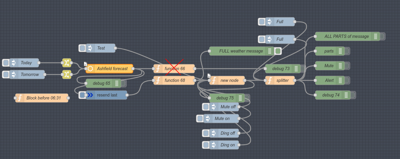

Openweather node - am I going over the top with this?
(also google TTS node)
I'm still at the shallow end of Home Automation.
I have written a nice bit of code with nodes to do a visual display of the weather at that point in time.
I'm expanding with the TTS node and wanting a FORECAST of weather too.
So in the morning, I can get a bit of an idea of the day's weather.
(putting aside the 90% inaccurate history of weather forecasts)
So I got some help and this is what I've got.
I have two options here: Today's forecast and Tomorrow's.
(Yeah, I keep older versions to kinda help me see the progress.)
function 68 is where the magic happens.
the new node allows me to add attributes like MUTE and ALERT too.
The splitter node is needed to split the message as the messages can get quite long/big.
Google TTS doesn't like messages longer than about 35 words. (Though I think it is more character limited, but anyway.)
And that is send to the enunciater part.

But I'm wondering is this ........ acceptable? People advocate when making code, to use standard nodes as much as possible.
Which I do get, but for this kind of thing....... Can that really be applicable?
It still isn't perfect and there are some slightly annoying repeats when getting for forecast.
But it is a LONG WAY better than the original.
Just wondering ...... (Well, I'm not exactly sure what I'm wondering)
Thoughts? :person_shrugging:

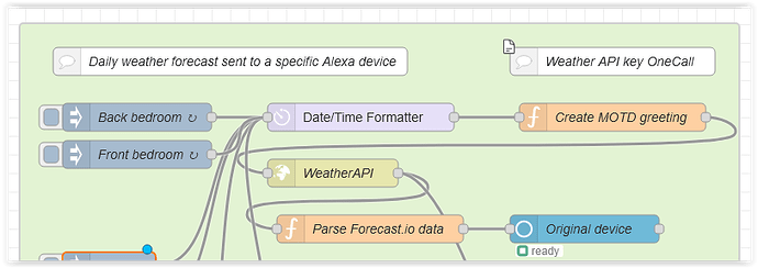

I've implemented something similar...
The Inject nodes (on the left) trigger the Date/Time Formatter at 07:00am and 07:15am each morning. An http-request is made to OpenWeatherMap OneCall facility to get the current day's forecast. The result is parsed to make a personalised report like...
"Hello Dave and Chris here is your weather forecast for xxxx. Today will be..... etc, etc. Tomorrow will be... etc, etc. Time now for a cup of tea. Goodbye and have a nice day."
The message is sent to an Alexa in a designated room (as specified in the Inject node).
This is what is in my 'Parse Forecast' node...
let forecast = "";
// current weather
forecast = forecast +msg.motd+msg.name+"<break time='0.25s'/> please standby <break time='0.5s'/> here is your weather report for Yateley";
