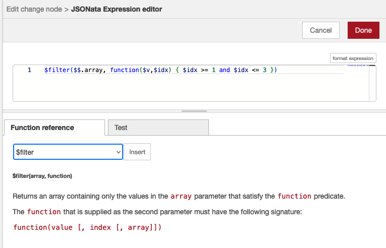

The benefit of using JSONata is that there are less function nodes and Javascript code in your flows. The dark side is that you have to learn JSONata syntax and concepts --> jsonata.org --> it has similarities to Javascript but also XSLT.
But JSONata is really well integrated into Node-RED, having also a test panel in the JSONata editor:
And documentation on each function that is available:
