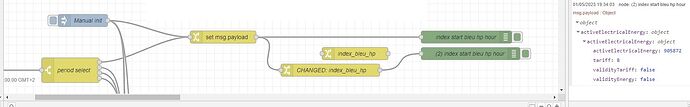

I would like at the "index start blue hp hour" level to retrieve only the activeElectricalEnergy value (without the tariff) but the node that I added does not work.

This is all the same error that I described above under ISSUE 1.
If you have a string in payload (i.e. payload = 'foo'), you cannot simply move it to payload.activeEnergy; meaning all the change nodes named index_<some color>_hp that move payload to an attribute will not work.
See red arrow:
You can do it like I showed in the node CHANGED: index_blue_hp
image.
It defines an object {"activeElectricalEnergy":msg.payload} via JSONata and attaches that to msg.payload. Hence, after that msg.payload.activeElectricalEnergy equals msg.payload.
I had tested this solution but I get the "activeElectricalEnergy" and "tariff" values when I would like the number of "activeElectricalEnergy"
