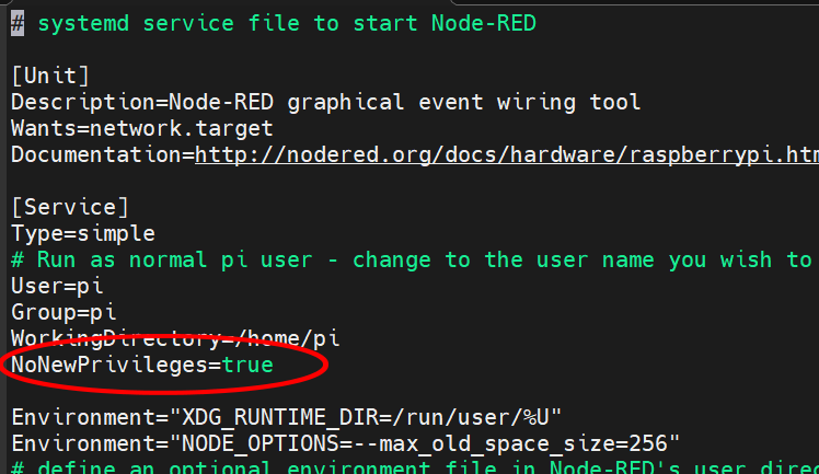

The message
sudo: The "no new privileges" flag is set, which prevents sudo from running as root.
sudo: If sudo is running in a container, you may need to adjust the container configuration to disable the flag.
is a consequence of this line in your /etc/systemd/system/multi-user.target.wants/nodered.service file:
Change true to false (you will have to edit the file using sudo in a terminal) and reboot.

I duckduckgoed it Colin & found mentions of it in a systemd script for a different application.
Adding the line to my Node-red script on a Pi Zero 2 with Bookworm caused the same message when I ran an exec command with sudo.
As I said, I've never come across it before.
I have no idea where it comes from and I don't see it in the current Pi install script (though it has possibly been added to the model systemd script file).
Even if it was in the install I would not see it because all my Pies already have modified systemd scripts, which do not get overwritten.
