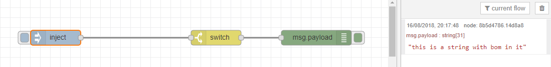

I need to check if my msg.payload out have the work "bom". I put the switch node and dont have success
This should help you
[{"id":"c4dc9486.8bb738","type":"inject","z":"dc97015.997e9","name":"","topic":"","payload":"this is a string with bom in it","payloadType":"str","repeat":"","crontab":"","once":false,"onceDelay":0.1,"x":610,"y":80,"wires":[["19c6b999.e75d56"]]},{"id":"19c6b999.e75d56","type":"switch","z":"dc97015.997e9","name":"","property":"payload","propertyType":"msg","rules":[{"t":"cont","v":"bom","vt":"str"}],"checkall":"true","repair":false,"outputs":1,"x":770,"y":80,"wires":[["8b5d4786.14d8a8"]]},{"id":"8b5d4786.14d8a8","type":"debug","z":"dc97015.997e9","name":"","active":true,"tosidebar":true,"console":false,"tostatus":false,"complete":"false","x":1210,"y":80,"wires":[]}]
The contains option is case sensitive. You need to use every combination you can figure out if you need to find them from arbitrary text.
